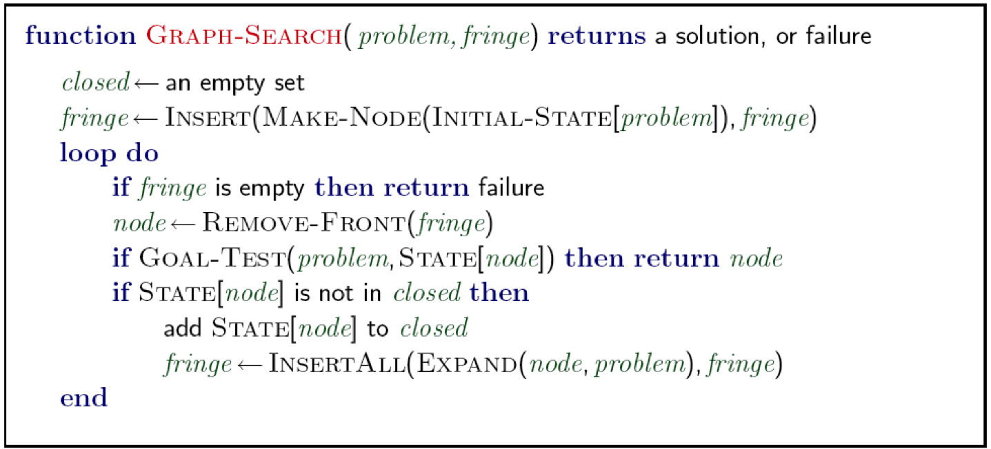

anladinmi
Dersin forumundaki Where can I find the pseudocode for the search algorithms? konusu yardimci oldu.
DFS ve DBS için stack 'tan çikarma (REMOVE-FRONT) buna benzer fonksyonlar olmali :
     #Fringe selection function
def DFS_GetFirstFromStack(fringe):
    max = -1
    Idx = -1
#maximum uzunluktaki dügüm
    for i in range(len(fringe)):
        if len(fringe[i].pathhisto) > max :
            max = len(fringe[i].pathhisto)
            Idx =  i
    return Idx
def DBS_GetFirstFromStack(fringe):
    min = 1000000000
    Idx = -1
#minimum uzunluktaki dügüm
        if len(fringe[i].pathhisto) < min :
            min = len(fringe[i].pathhisto)
            Idx =  i
    return Idx
EXPAND-ALL:
            for Successors in Expandlist:
                histopath = list(CurrentNode.pathhisto)
                histopath.append(Successors[1])
                #Add successor in fringe
                SuccNode = TSearchNode([Successors[0],histopath,Successors[2] + CurrentNode.gcost ])
                #print "Adding Fringe:",  SuccNode.xy, SuccNode.pathhisto, SuccNode.gcost
                # xy, Dirhisto, cost
                Fringe.push(SuccNode)
